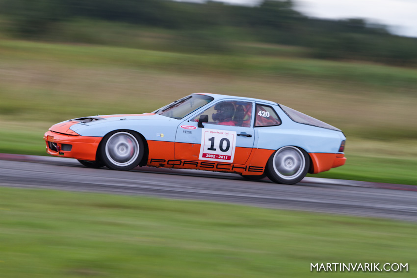

Hello to all!
No updates for quite some time, but athe car drives and even though few issues need to be sorted out (need solid camber plates for front struts, new clutch which I'm changing right now), it drives well. and car is pretty fast.
I'm in the process of fabricating tubular exhaust manifold and I'll use Holset HX35 with twin-pulse turbine next season. The main reason for new manifold (and new turbo at the same time) is extremely poor access to oil lines, filter etc with stock 931 exhaust manifold.
And since I have 4 Porsches at the moment (white 924 2.5 16v turbo, turbocharged 2.0 red 924, 931 Gulf and '78 911) I will sell two of them. 931 Gulf is for sale and my red turbocharged 924.
Here's few photos of the car:
