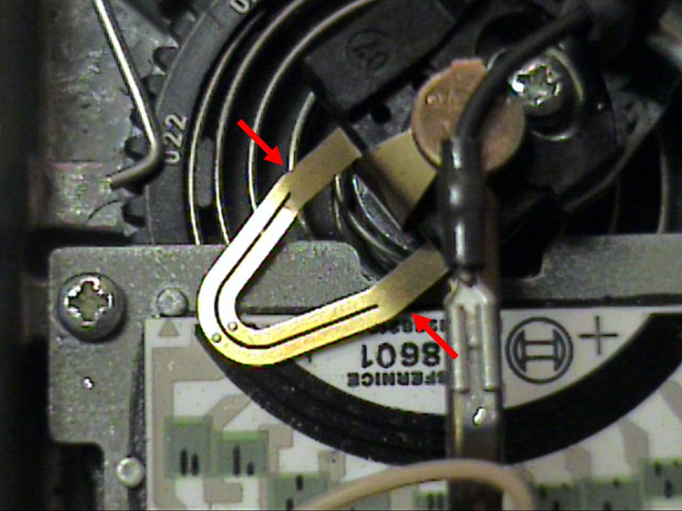

Koppla ur LMM och prova bilen, den skall gå dåligt, men iaf över 1500 varv.

Mattias, det är kolbanor i LMM som blir slitna med tiden. Man kan böja ut löparna lite så att de löper bredvid det slitna spåret.

Place a piece of paper between the wiper arm and the potentiometer conducting strip. Change the position of the wiper arm by pushing down on both sides of the back part of the wiper arm (see arrows in picture below) to bend the arm slightly. This effectively shortens the arm such that the contacts on the bottom side of the arm will ride on a different (ungrooved) part of the conducting strip.
illustration:
http://www.clarks-garage.com/graphics/a ... -arm-2.jpg
http://www.clarks-garage.com/shop-manual/elect-22.htm
