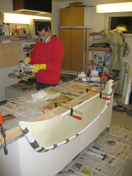

We have molds for Gemballa/Sanden/AIR/Strosek/etc style front spoiler. It would be quite difficult to fabricate a "decent" looking spoiler from carbonfibre. This spoiler must be done in two stages; so you have to have a mold for upper part and the other mold for lower part. That's mainly because the shape of this spoiler does not allow to make it using just one mold. So i suppose most of you would like to leave spoiler to "natural" carbon surface and not paint it. In that case there will be a visible seam where these two halves are laminated together. Carbon fibre is also more demanding to laminate, in most cases you must use vacuum sacking method which is quite difficult to arrange in your own garage.
Here's some pictures of the pieces we have made:
